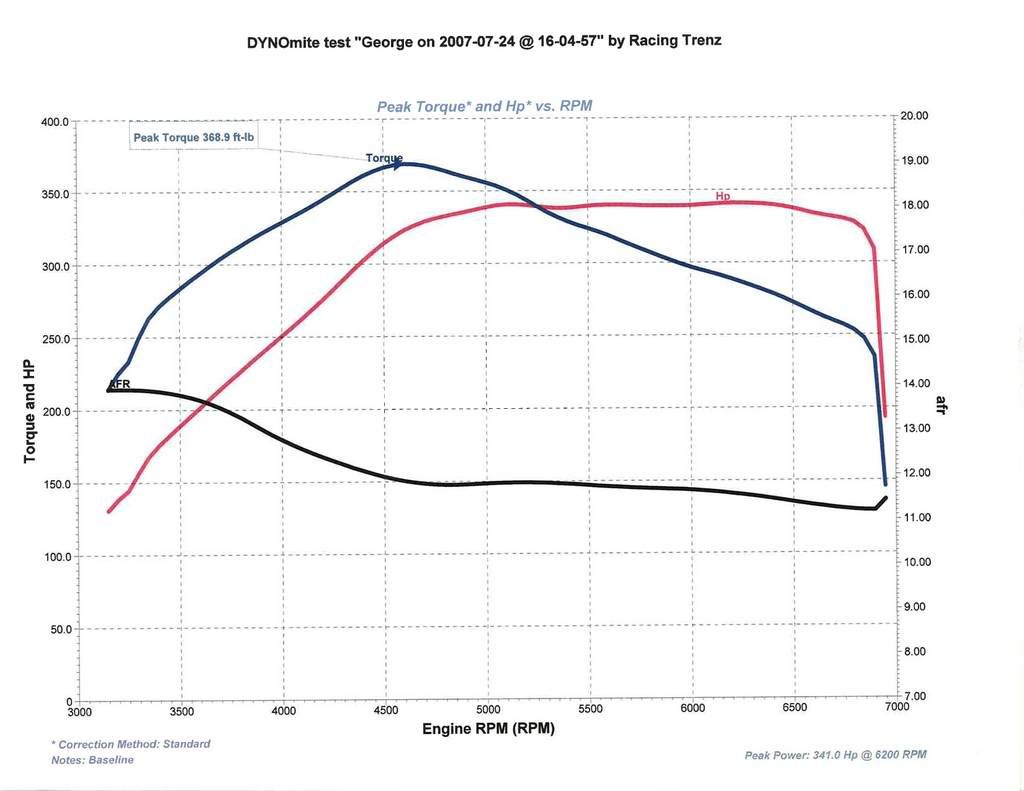

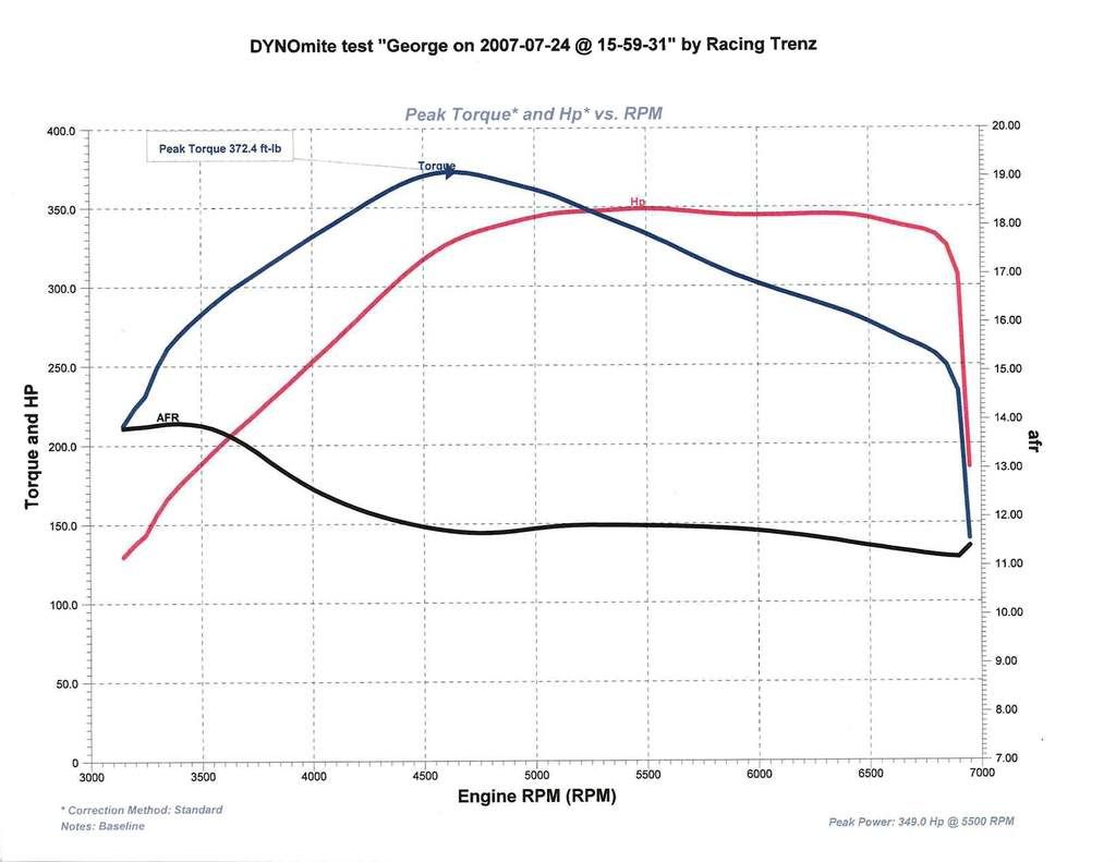

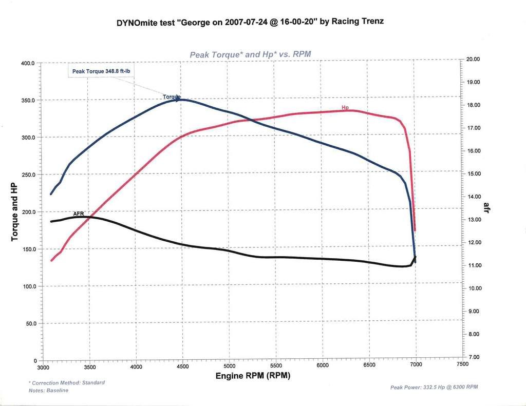

(#3) I've been curious to put my Z on the dyno since doing the TT swap. Since I was there, and it seemed like they had the time, I went ahead and asked them to dyno it. Here are the results:
________________________________________________________________________________________________________________________
1990 2+2 TT: JDM Engine with stock injectors and stock turbos (read my profile for more info)
Ambient Temperature: 95-100 degrees F
Time: 5:00 pm
Fuel: 91 octane (standard premium unleaded pump gas - Colorado doesn't sell 93 octane)
FIRST RUN: 1.2 kg/cm2
SECOND RUN: 1.0 kg/cm2
THIRD RUN: 0.9 kg/cm2
During the first run the boost gauge was set to 1.2 kg/cm2. He could hear some pinging so they cut the pull short. The second and third pulls they adjusted the boost gauge down to 1.0 kg/cm2 and 0.9 kg/cm2. I am going to leave it set to 0.9 kg/cm2 which he said is a safe level. The car blew hefty amounts of black smoke when it hit the higher rpm's. I half expected the car to blow up or pieces of shrapnel to come flying out, but it didn't.
So tell me... Is this good or bad???
